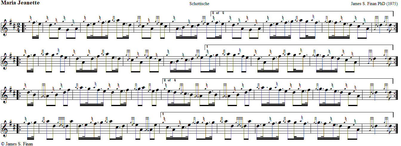

Post by finan » Tue Oct 02, 2018 5:17 pm
[attachment=0]t-Maria Jeanette.png[/attachment]

Post by philamor » Tue Oct 02, 2018 7:23 pm
Hi, I cannot help but wonder if the tune does progress in complexity, but misses a few tricks, like throws added in the 3rd part and the birl in the 3rd part written from the B's as a birl with the low A gracenote added (abr instead of brl in Bagpipe writer Gold, for example), with a G birl in the 4th part 3rd bar to compliment the complex gracing on the D in the 1st and 5th bar (gbr instead of brl). This springs to mind initially as one reads down and looks for the piper to add something extra as the piece progresses, but only my thoughts.
